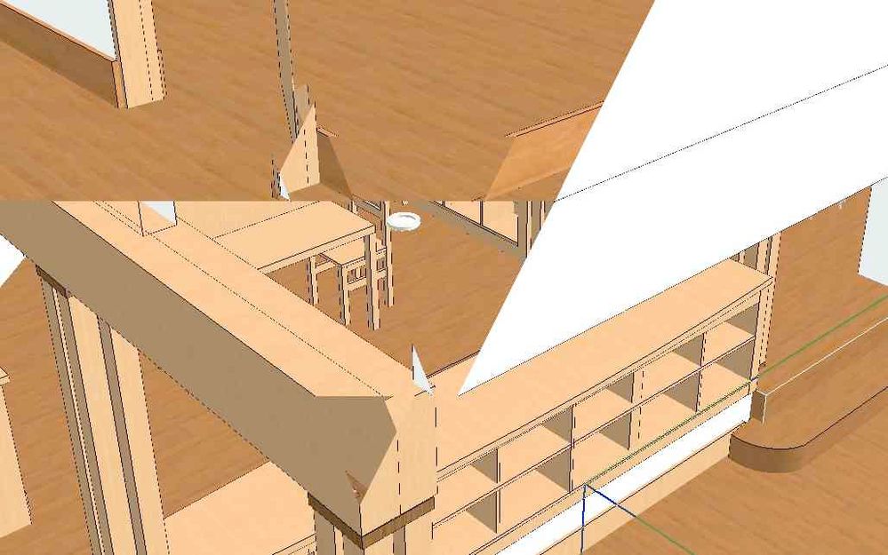

I've got this thing going on where when I'm navigating my model it cuts out elements in the near view.
This must be cause be caused by a setting? Any ideas out there?
I should add that it only happens in this one project, created on another machine, and shared with them. On their machine (also a Mac) it doesn't happen.
Thx
image attached

You should put your computer specs and software version in your signature. It may help to narrow down the problem. Several possibilities come to mind. You could have a problem with an SEO operation run amuck. Could be video driver or card problems in OpenGL.
Gerald Hoffman
“The simplification of anything is always sensational” GKC
Archicad 4.55 - 29-Latest USA
2024 M4 Max MacBook Pro-macOS 15.5 (128GB (16 Core CPU + 40 Core GPU)
Dwight
You'd also want to state your Archicad version since there was a bug like this in prior releases that was fixed. Have you checked for updates recently?
Dwight Atkinson
Dwight
Yup. Check that you have the current "build."
Dwight Atkinson
It looks a bit like the 'cutting plane of doom' problem. See here for cause and possible solution -
http://www.archicadwiki.com/Bugs/Model_cut_in_3D
