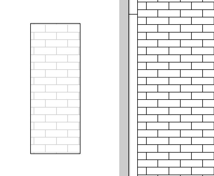

Regarding my elevations, can anyone advise how I can select one colour for my vectorial hatching (fills) and another for my outlines?
The 'Vectorial 3D Hatching' box is ticked in the Elevation Settings, but I can't seem to find out how to select one colour for the hatching and another for the uncut lines, i.e. the outlines of my elevations. I have attached a jpeg image showing what I need, on the left, and what I get, on the right.
Naturally, I can achieve this by using fills, but this is extremely time consuming and I would like to find a more practical, automatic solution instead.

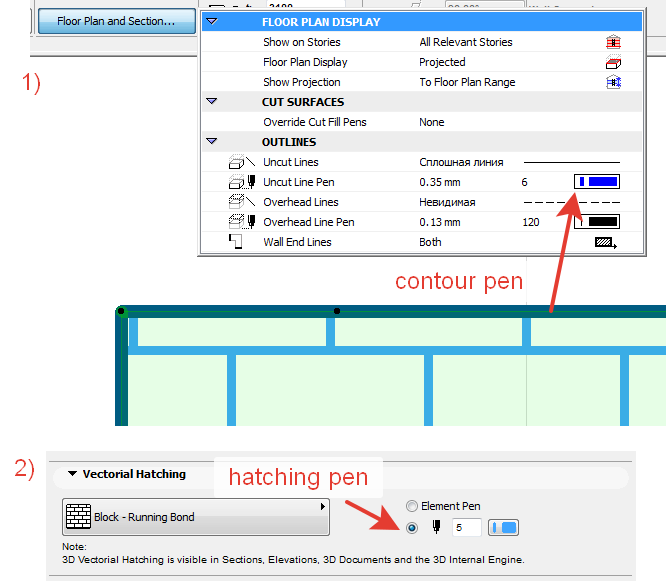

Hi, man!
This makes by some combo of settings: 1) Outline pen in object options 2) Hatching pen in Material options

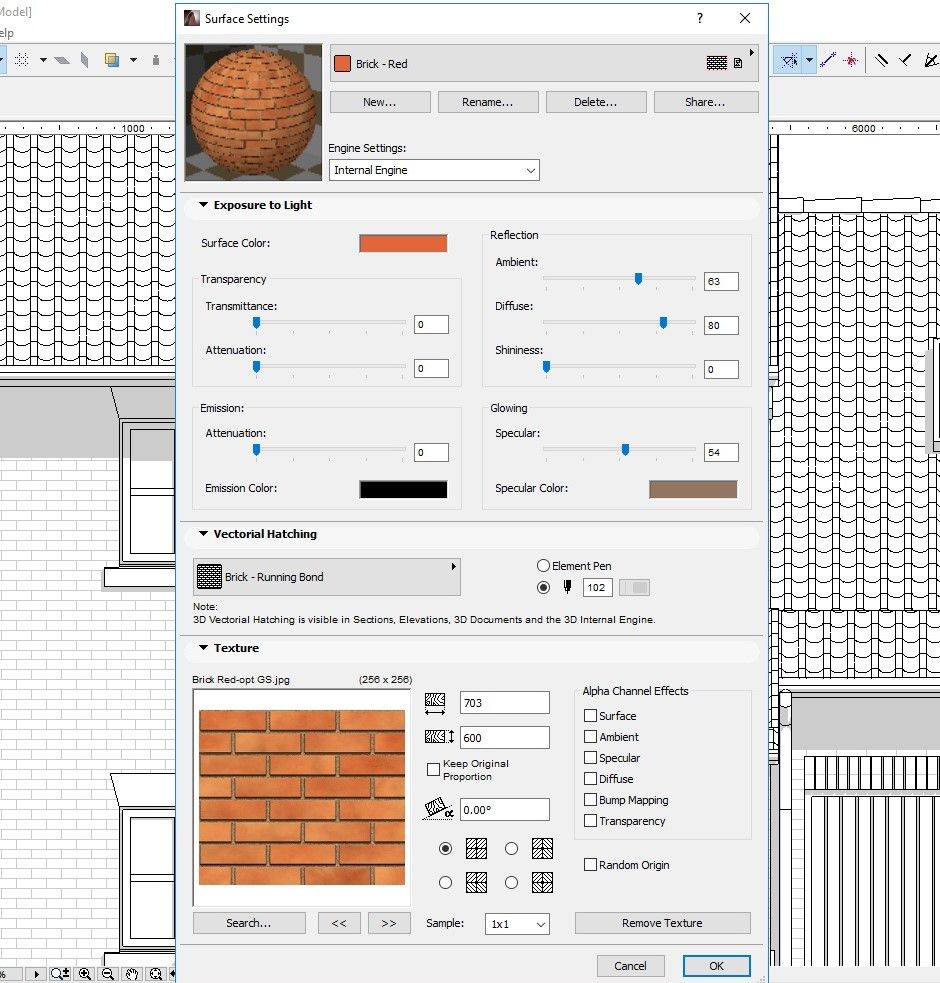

It took me a while to find the material options, but when I did, they allowed me to do exactly what I needed! Thanks very much for the help!
For those of you with the same issue, you can find the vectorial hatching pen settings in the 'Surface Settings' options. See attached jpeg.
