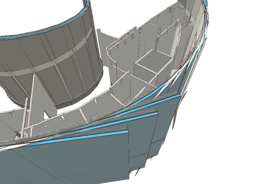

How do I fix these complex wall connections? The wall with the blue insulation is a fairly complex faceted wall with a very shallow angle. It looks fine in plan.
I have been playing around for a while but I just can't seem to correct it.

Dwight
Hot line inside?
Dwight Atkinson
/\ Yes the centre line is set up to a specific material face within the wall. (Is that the Hotline?)
Are there any voids?
If so fill then with an empty fill
That seemed to help. I changed my air space to a black coloured empty fill (to help with rendering) I also found that a small component of the wall at the base was interfering with the connections.
Give the different number for layer, for example 1 or 2.
