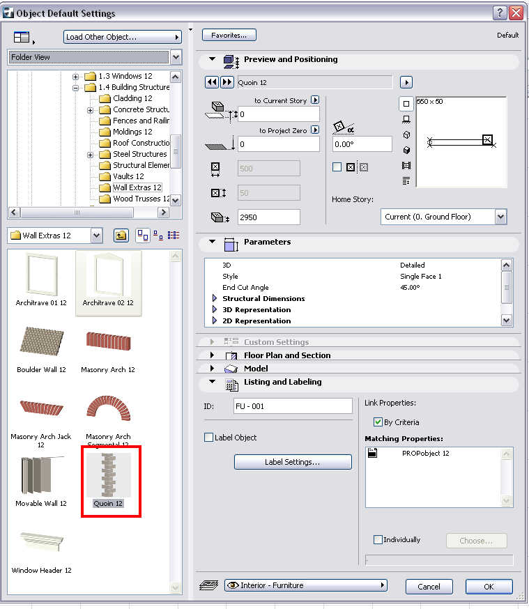

Did you had a look at "Quoin" object that comes with Default ArchiCAD Library

JUST what I was looking for ! Many thanks.
