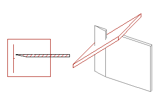

I have just found out, that an overhang part of a Wall End object does not trimmed to roofs.
May be it was discussed already.
Is it a bug and may be anybody knows any workaround to force it to be trimmed (excluding SEO).

Hi Olivier,
I know the option you point me, but it does not help.
Wall End dont trimmed only if the roof polygon doesnot cover the wall completely. See picture in my the previous post.

Curiously, it works better with curved walls.
There is a workaround.
Modify the wall to a curved one. Trim to roof. It works correctly.
Then modify the wall to a straight one. The cuting part remains OK.
Not very elegant, i agree.

For interested users, here is an image of the workaround,
i hope more understandable than my garbage.
