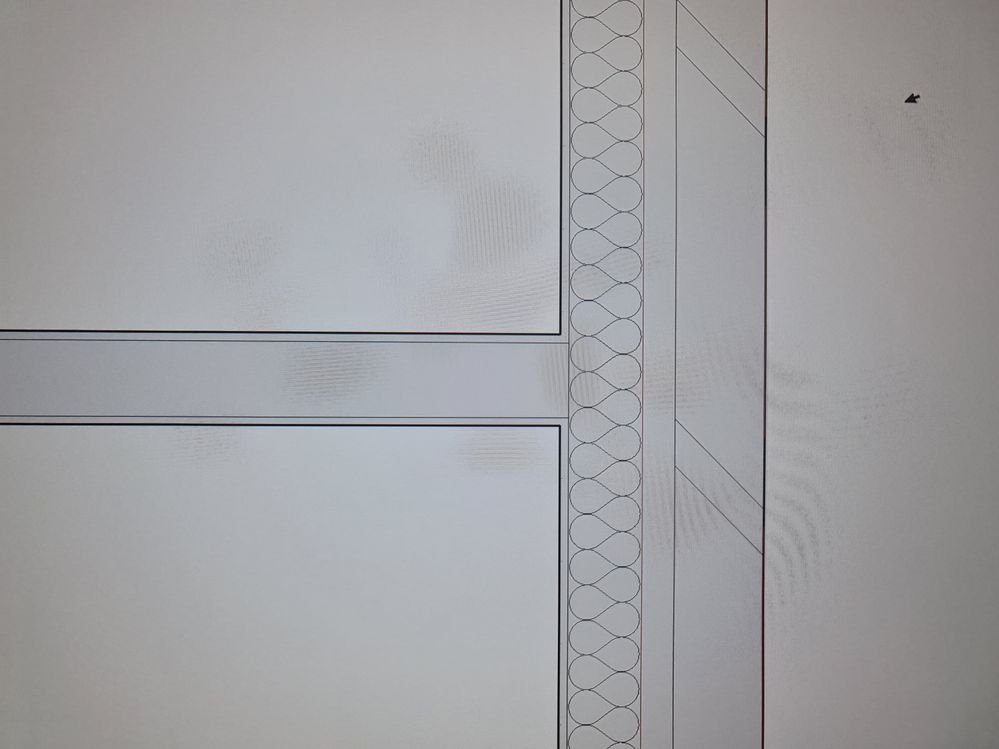

I've got a complex wall profile I've created, and I wanted to see if there was a method by which I can manipulate the view to display differently in Plan and Section.
I have a cut fill in one of the skins that I only want to display in Section. It runs the entire height of the wall.

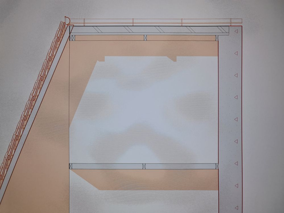

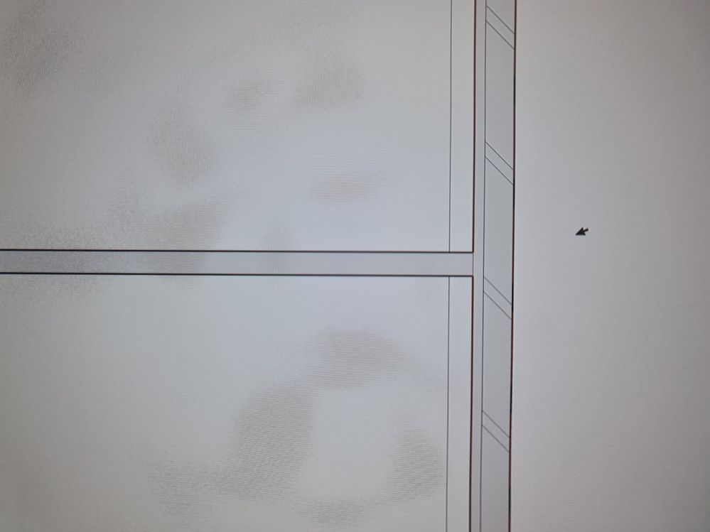

Appreciate the response, I've tried that, but it's a cut fill I'm trying to hide whilst showing others.
I've got other finish skins and am using partial structure display.
The issue is the 'finish' fill is overlayed on top of a 'core' fill and using priority settings I can't get the interactions to work properly at the same time in both views. Ideal viewIdeal viewCore Skin missing, funny interactionCore Skin missing, funny interactionCore skin missingCore skin missingIdeal view except for insulation being shownIdeal view except for insulation being shown
