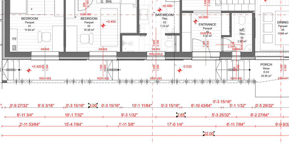

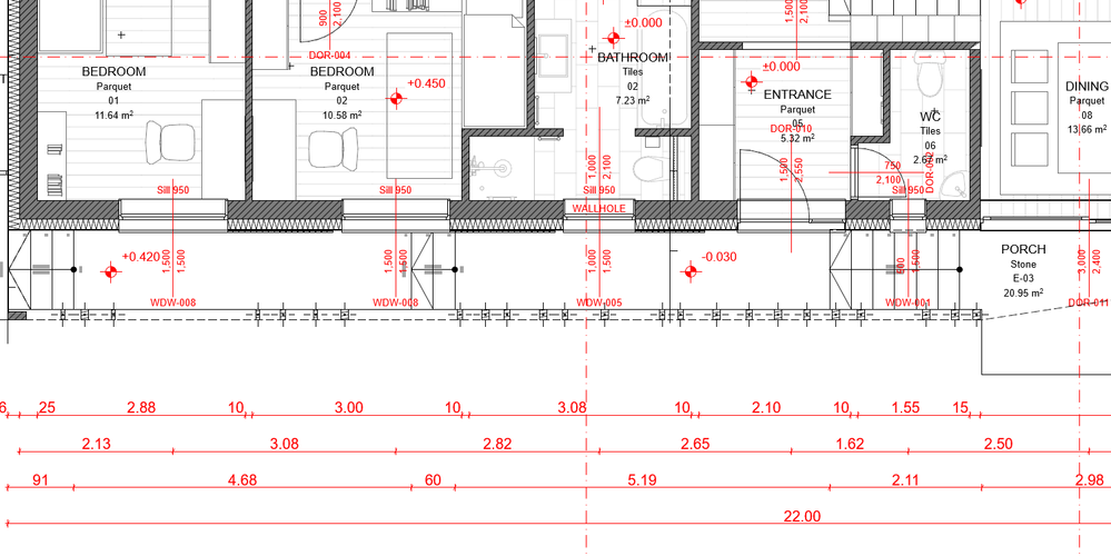

So, here is an example: in the below floor plan, 3 Dimension Texts have been modified from their measured value:

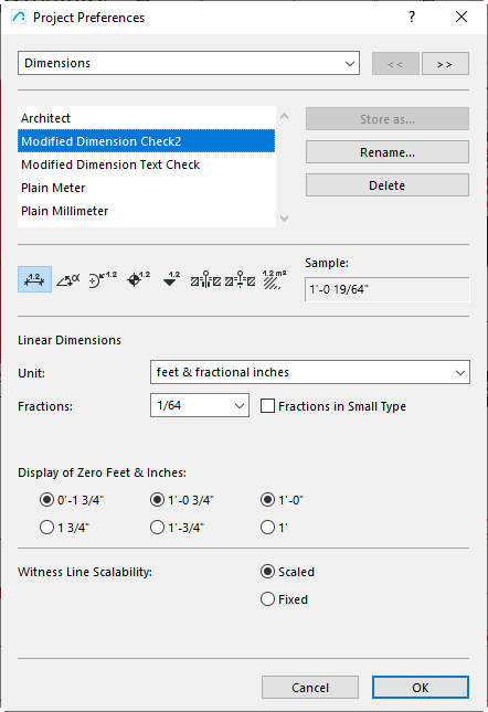

I create and save a new Dimension Settings set. Since I am working in metric, I will make its unit "Feet & Fractional Inches" with the highest accuracy and always displaying zeros everywhere. This way, measured dimension values will both be long and in feet and inches - very different visually from my metric dimensions. Here is the Dimension Settings:
And here is the result:

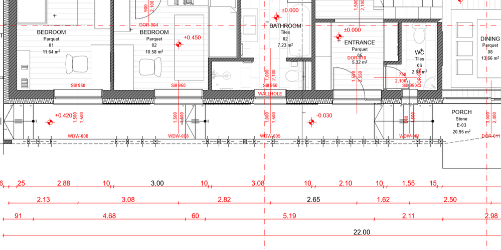

Now it is relatively easy to spot the three Dimension Texts that are in metric because they are all much shorter than the rest, and now I will set them to a different color as well so they will be easy to spot in the future. Then I just switch back to the usual dimension display and the issue is sorted.
