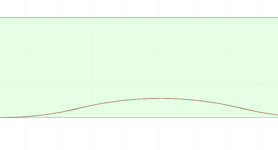

How does one make the top of the wall wave like the line in the picture? The wall will be 2 or three different colors and the line will be a ribbon that goes around the building.

You can do the following:
Create a custom profile the shape of the curves, then model them using a beam on a hidden layer.
Use Solid Elements Operations to subtract the top of the walls from the shape, then hide the SEO layer and voila a curve top wall.
