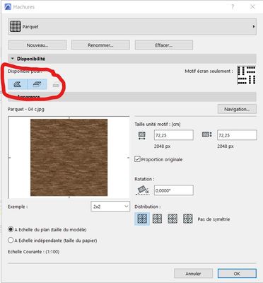

In the Fill Tool, the type of Fill to use. Fill from image is only avaliable for Sketch Fills and Cover Fills.
 In the Fill definition, the type of Fill you allow for your Hatch.
