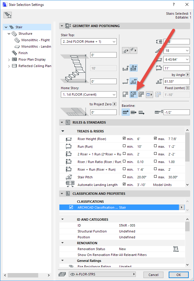

Do you have this winder icon selected?
Richard
AC26 (since AC6.0), Win10
Dave Jochum
Oh yea...I've tried them all. It's a very complex tool. There are numerous settings that affect the outcome of a stair construction in ways that are unpredictable to the new user. I'm sure some things are better accomplished in edit mode than the original creation, but the complexity is even greater there.
