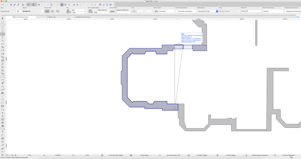

Hi all,
I am currently drawing a renovation for a Georgian house and have stumbled upon this problem. When I attempt to place a window on the morphed wall it seems to want to go through both walls when I only want it to go through one. Is there any solution to this?
Thanks,
Fin
2 Replies 2
Draw separate walls or split the current one at the corners so it doesn't overlap with itself

At this stage of the project, you should be able to convert the morph sketch into a real BIM wall to keep developing it. That is about one of my proposals to Graphisoft. We can't use Archicad as a simple 3d software, but as a full BIM one.
