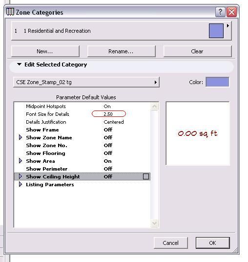

I have made a new Zone Stamp from the Existing "Zone Identifier 2".
The attached screen shot shows that the font size for details is 2.50....
While Typing this I just figured out that this is "mm" and not points. I want 7.5 points so I will set it to 2.65mm.
One Problem solved.........
