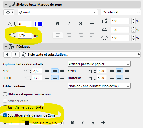

Hello,
I want to have different size for my zone name depending on the scale I use, even though I choose to overwrite it, it only changes the font type etc, not the size. However for surface, zone number etc. it does change the font size. What's the point of this function if it doesn't workt for zone name?
Thanks,
Liene

A mod can move this to the Documentation sub. Should probably have a tag relating to annotation since it has nothing to do with Design Options.
What do you mean by "I chose to overwrite it"? Are you using a Zone Label or Zone Stamp. For labels, you could have seperate ones for each scale. For the stamp, there is a "scale sensitive" setting where you can customise the display for each of the limited set scales.
Ling.

For zone name the size stays 1,7mm no matter what scale I choose.
2 weeks ago
I have the same problem, can't seem to have the title that I overwrote to have it in Bold in the correct size, it
