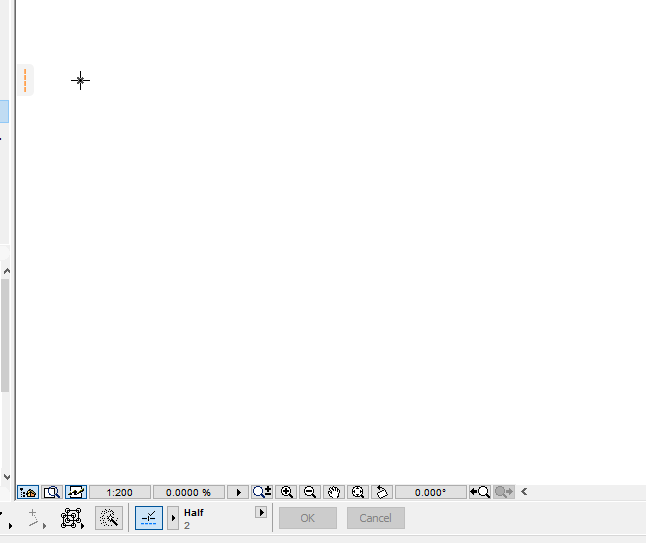

archciad zoom defaults to 0%
On all my plan files in archicad 19 it has defaulted my zoom function to 0%. I have had to 'save current zooms' to be able to view my plans without having to scroll in everytime. Before i think it defaulted to 90% zoom. is there a way to get the zoom back to that? would save a lot of time.
1 REPLY 1
Katalin Borszeki
Hi All, This setting is saved in the template file. To fix this issue, please set the Zoom to the level you wish to have it, and save the file as a .TPL. Then reopen your plan file with this template. Best, k
