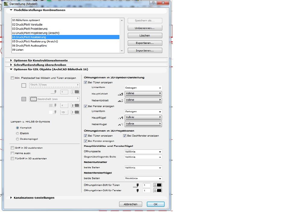

Some standard AC objects have a variety of display options (as seen in the image below), and Cadimage's Cabinet Tool goes even further with options to display all internal shelves, carcase, toe kicks etc. too, which can be controlled within the object and in Model View Options.

I'm using the standard ''sink cabinet'' from the AC16 library. See attached file (objekt). I tried to change the setting in the model view options but i dont see the cadimage object tool (see attached model view options).
Is the cadimage options an add on?
Thanks for your time.
