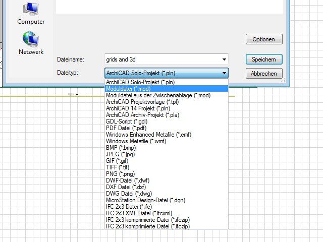

I am testing archicad 15 and i want to save as a artlantis 3.0 file.
i have checked addons and it is installed.
But when i go to SAVE AS, i can find lots of options but nothing for ARTLANTIS ?
See graphic attached.
Please can you help me.
Thanks.
Ian
2 REPLIES 2
yes, you have to view the model in 3d instead of 2d drawing and from 3d view try to save it as artlantis you will definitly find the option save as artlantis 3.0 when you are in 3d view
