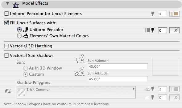

Colored elevations in analytical section window
setting in section dialog attached

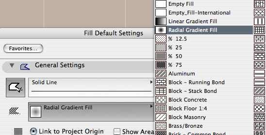

graduated fill - now on the list of fills

Dwight
locating the graduated fill
Dwight Atkinson
