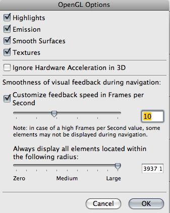

You can reduce the OpenGL demands by reducing options.
3D Window Settings.
