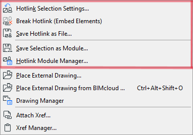

Hi all,
In addition to the a/m solution I can tell you that,
as Archicad is not an ordinary 3D modeling software as (AutoCAD, Sketchup or even Revit) and as it's a real BIM solution it won't handle elements as other applications do it, rather it handles the elements' information also to deliver them as expected.
So, try to save those selected elements as a module file, then placing them in the appropriate floor plan in the other file & break hotlink to embed the elements into this file.
See the attached screenshots showing the profiles before I transfer this complex profile column & after I placed as a module, I hope that helps.
AC 29 INT 4006/WIN 11
