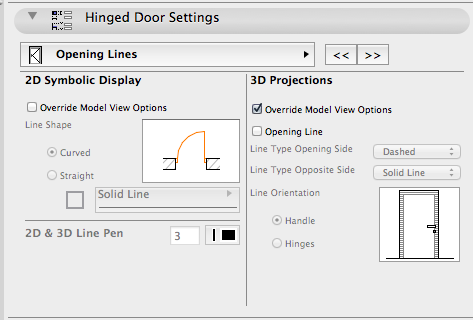

How do i hide the door opening lines symbol - in 3D - on the standard AC doors?

Document -> Set Model View -> Model View Options
TIA
In the Door Options,
You have an Opening SubSet
Click to Override, Uncheck Opening lines in 3D
Eduardo Rolon
FYI Bogdan option is for a particular door, the MVO option works with all the doors in the view.
