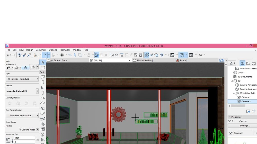

embeddend library objects in the fly through the visible con
In my 3d camera view embedded library objects are described in green or orange lines and in the fly through the visible contours of these objects. Can it be turned off because my animation looks unfinished. please help
1 Reply 1
In '3D Window Settings' for the OpenGL engine there is an option to turn the contour lines off.
