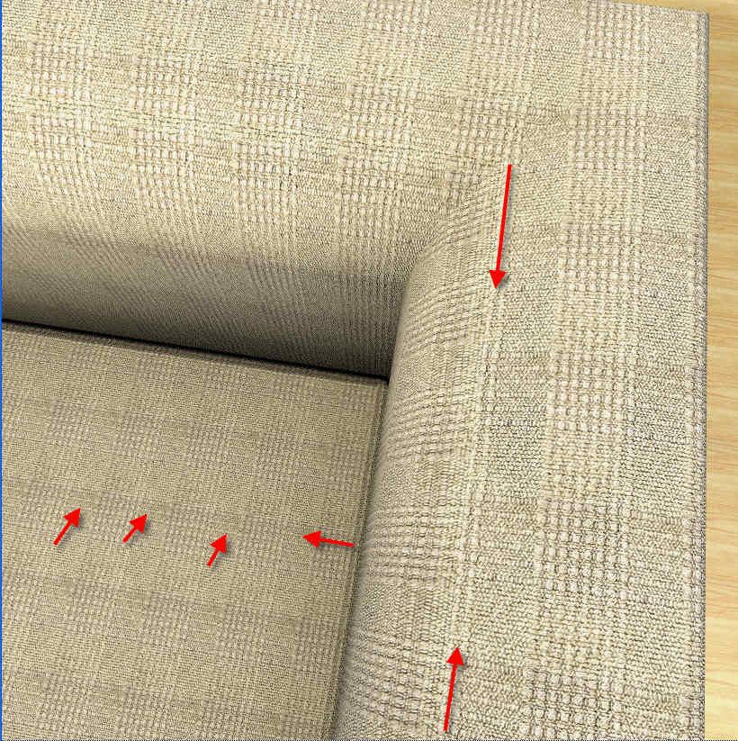

Again, for our student, here is the result of creating an ArchiCAD material using the resulting texture image and applying it to the "Sofa 03" library part.
You can see a few issues with the result. The image repeats seamlessly, but there is a stripe (pointed out with arrows) that is darker than the rest of the fabric ... this is because I didn't take the photo in a location with even lighting. [Edit: see Dwight's post on 'pulsing'... posted while I was typing this! Thanks Dwight!]
Within that dark stripe, you can see a repeating little dark "glob" ... something that could have been fixed in Photoshop.
The most unsatisfactory problem is the way the fabric wraps onto the arm of the sofa. You'll see that the pattern on the top of the back and top of the arm all aligns, but the side of the arm is offset. This is an issue with the actual GDL library part and cannot be fixed without GDL coding. A similar thing happens in the curved part of the back, the stripes align, but the pattern is shifted up. No user control over this.
