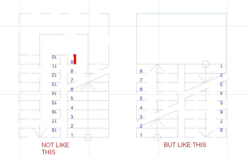

how to do a stair like this?
Hello, I have to do a stair like the one in the right part of the attached pic. The area marked with red must be 0, thus the flight of the stairs being aligned. I want to use regular Archicad library parts not customized stairs and I have to make the stair in one piece, not 2 stairs and a slab. Which option I have to check/uncheck because Archicad won't let me to do this.
Thanks!

Zero depth returns are not possible with Stairmaker. It seems you are already aware of the other options such as:
1. Just make it as small as possible if that's close enough for your present purpose.
2. Build the stair from separate flights of treads.
3. Use Archistair or the Cadimage stair tool.
4. Build it out of parts.
As far as I know this is what you are stuck with. It is an unfortunate limitation in Stairmaker. In their defense it is a tricky detail to work out (particularly in wood trimmed carriage stairs) and it is illegal for public/commercial use in the states so the need to model this condition is rather rare at least over here.

In Stair Maker:
1. Go to Structure ans landing settings
2. In Structure type choose the far right option
3. Now go back to Geometry and flight settings and you can use zero values!
The bad guy is the Nosing size on the front.
