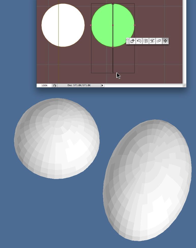

Matthew: How would that look?
Dwight Atkinson
thanks for all the advice, it sure helps a lot.. regards!
Sort of like this one but it was done with meshes. I haven't tried the walls for this yet.
Dwight
If you have a binary dome, you stretch it.....
Make a binary dome by:
1: take any dome object
2: Make a top view in 3D
3: Save the view as an object —— "Binary" option.
4: Now the saved object will stretch to become oblong, taller or flatter as you wish...
Have a look at "Object Making with Archicad" to get more insight.

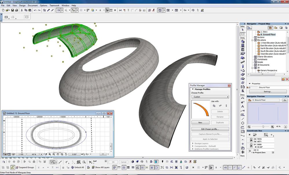

Here's a try with the Complex profile tool. Since the Complex profile tool (through the magic wand and the wall tool) approximates the curvature of the ellipse from a series of connected curves at either the top or bottom of the object, it wasn't possible to get an exact recreation of the exact ellipse shape (shown by the blue curve in plan) nor to complete the top portion of the dome. The top portion would probably have to be finished with some other method like meshes, like Mathew did.
In fact the mesh method would most likely be the most accurate (but cumbersome) while the traditional Dome -> Binary object method that Dwight showed would be the easiest and most manipulatable although not as accurate in terms of getting exact elliptical shapes in plan and elevation.
But with the Mesh method - which I would opt for - you can then use the Mesh-to-Roof tool to convert the resulting dome into a series of roofs for a Complex roof ( but lots of geometry and difficult to manage), or leave it as a skin and use it as is.
Bricklyne wrote:
..., or leave it as a skin and use it as is.
It's not just a skin. I dropped a second mesh and subtracted from the first to make a solid roof with thickness.
