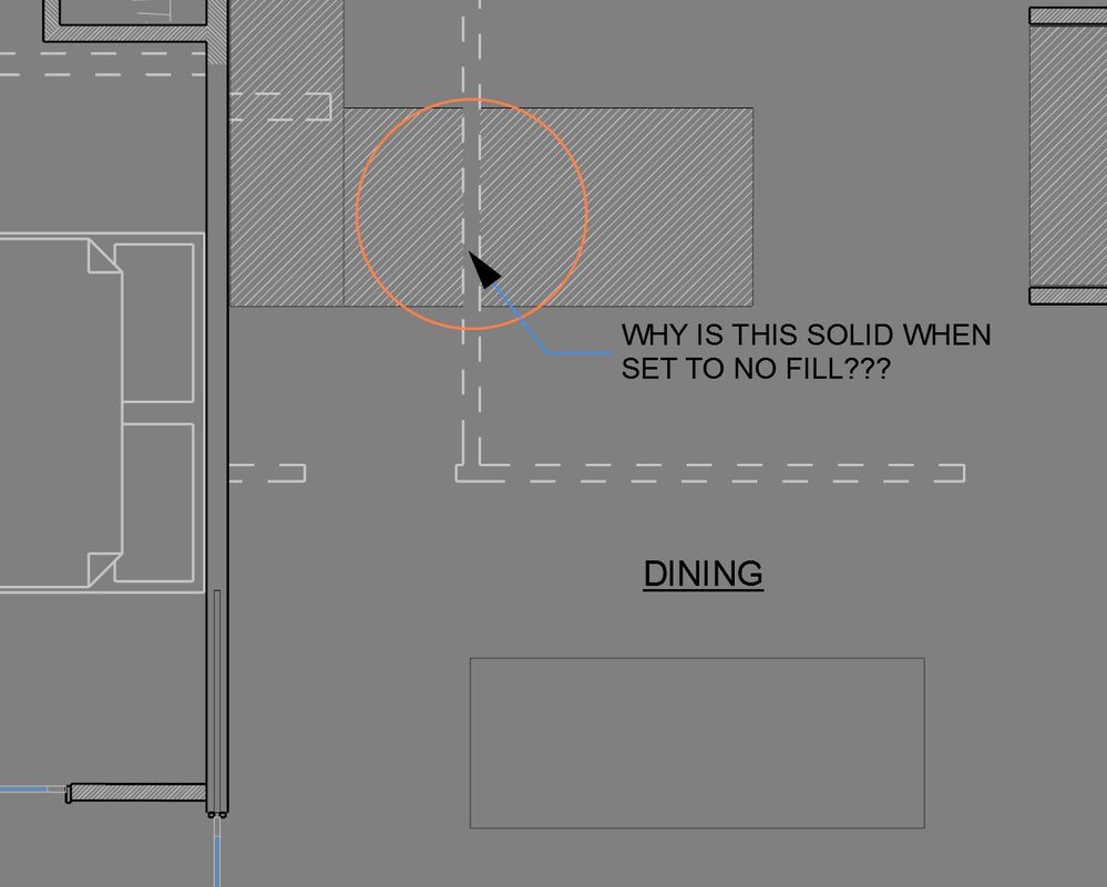

One issue I am having that seems like a bug, is that I can't seem to make the background fill empty on the demolished walls. I want the dashed line to show over every thing with no fill. Am I missing something?
Have tried every setting I can think of in the Renovation Filter Options palette and the Renovation Override Styles palette to no avail.
Very simple thing-immensely frustrating.
Image 1 shows the problem in plan view. Image 2 shows the palette settings.
Thanks for the help.

I was unable to recreate a similar condition. The appearance is such that the wall appears to be cutting through the hatch fill. What is that element? An object, fill, slab, roof, etc?

This happens to be a slab.
It happens with all objects, fills, etc...
Cannot get the demo'd wall to appear without fill.

I can reproduce your problem only when the Wall is set to Floor Plan Display > Outlines Only, try setting the Wall to a different Display option.

Good line of thought. I went ahead and tried that. The only setting there that worked was OVERHEAD ALL.
But got me looking through all the wall settings and turns out if I toggle the override fill button and set that to anything at all the wall uses the Renovation override setting. Does not even need to be set to empty fill, can use a solid fill. Only need to have the override radio button activated.
Thanks all. Satisfactory work around / quirk resolution.
