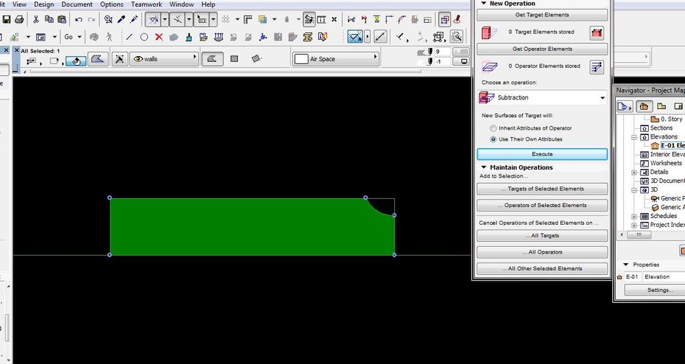

how to remove part of wall in 3d

second, what is the best way to do it accurately to match the elevation drawing
Please help

Use a round window opening.

no i do not want to make opening i want to remove the part of the wall to be curved in the end like the one in the image shaded with green

Right. Put the opening on the corner. Easiest solution.
Another way is to use Solid Element Operation with a cylinder or other object as the Operator.
OR, set up a custom profile beam in a wireframe layer to intersect with the wall. By adjusting layer and wall priorities, the beam will cut the wall.

yes i will try the first and second solution but actually because i am not very advanced user i can not understand third solution(profile beam) ,by the way thank you very much for quick response

See attached, this is just one solution.
