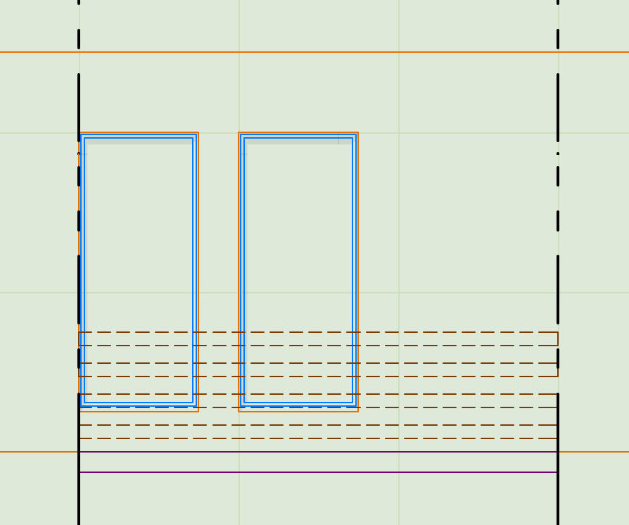

Eduardo Rolón AIA NCARB
AC29 US/INT -> AC08
another Moderator
Eduardo Rolon
and the elevation with GO
AC29 US/INT -> AC08
another Moderator

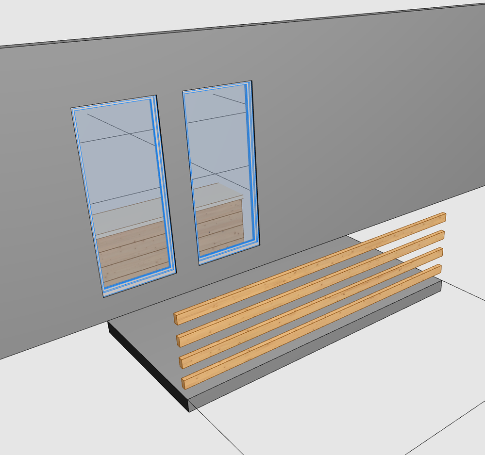

That's a start but I was meaning more along the lines of partial transparency, as per the original poster's question. Didn't make myself clear, sorry. It would be nice to have the effect equivalent to a 50% fill on glass balustrades so you can see detail behind them. Is this possible?
Eduardo Rolon
Like this?
AC29 US/INT -> AC08
another Moderator
That looks promising, Eduardo. How do you achieve that?
Eduardo Rolon
Created a New Surface based on Clear Glass with a 25% Fill, created a GO rule and applied the rule to the View
