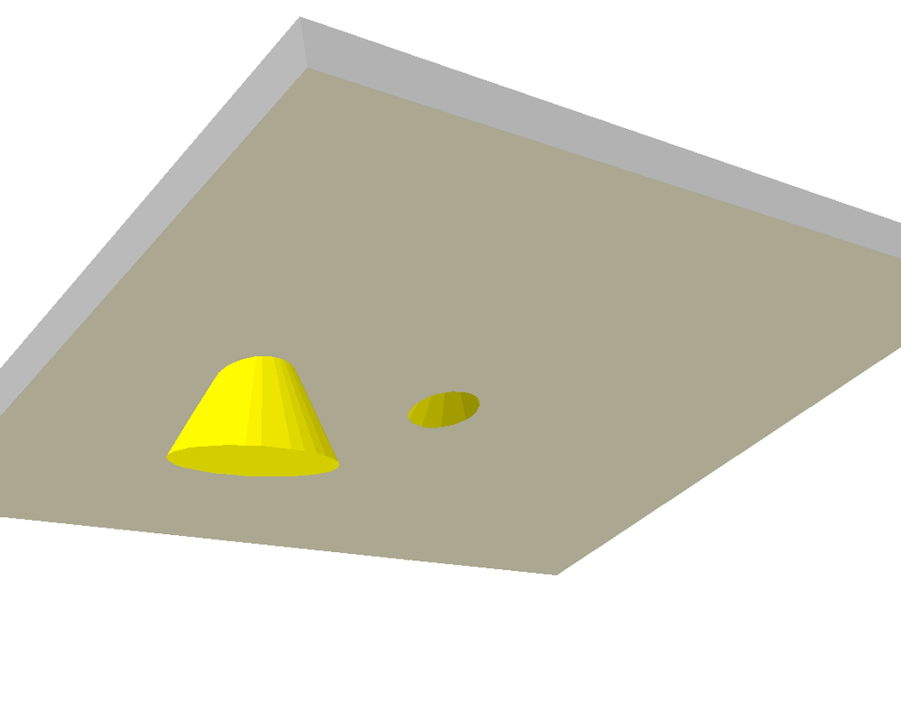

You could use the "Cone" object from: Special Construction> Basic Shapes> (in AC13).
Adjust the bottom circle radius as desired, place it in the ceiling and SEO it out (Subtract w/ downward extrusion, inherit attributes of operator). Ceiling has to be thicker than the cone. Hide the cone's layer.
It would create an oval hole in the ceiling as from a sloped ceiling can (as opposed to a round hole from a flat ceiling can).
You could place a lamp object in the cavity if your lighting a scene.

Thanks for the tip about the cone. Cleaver idea.
I actually do want a round hole in the ceiling. Recessed can lights in sloped ceiling have a round trim ring which is what I'm trying to model. For now I'm just going to cut a round hole in a thin ceiling element created with the roof tool. That will give me the basic shape without the trim ring.
Then I'll take your tip and put a light source behind the ceiling for the projected light.

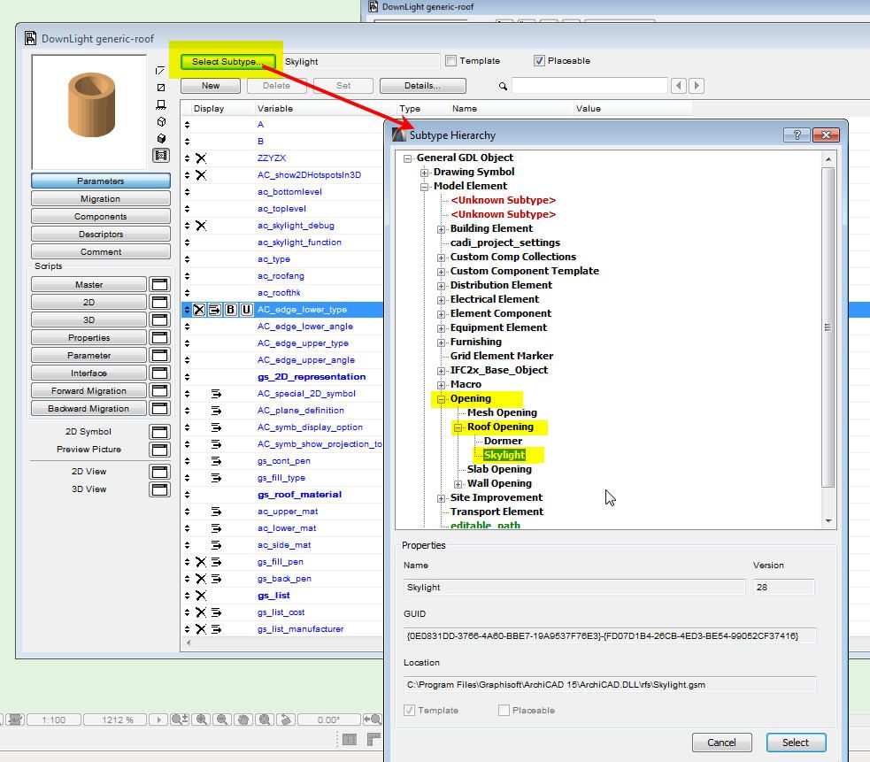

You could try saving your light as a new object (so as not to lose the original) and change the subtype to be a skylight.
Then you would have to add a ROTx ac_roofang command at the beginning of your 3D script to get the automatic roof slope.
I'm trying this but I've never done any kind of scripting for a GSM before.
How would I change the subtype to Skylight? I didn't see that as an option or script line.
I added the line:
ROTx ac_roofang above the first line of the 3D script after the object name but errors kept popping up when I tried checking the script.

Set the subtype here.
You may be getting the error becausr the "ac_roofang" parameter doesn't exist till you set the roof type.
