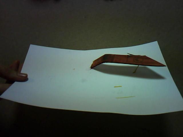

iclined wall+curved+slab
I wonder If i can make as what is shown in the picture as one object ....
One inclined wall complete to be a slab -having certain shap- with curved angle between the inclined wall and the slab!!!

The "complex profiles" tool is the answer
you could :
1- draw the wall and the curved part
2- draw the whole profile

So i think that i should draw the inclined wall with the curve wall in manager profile and the slab draw it separetly!!am i right!!
What about if i want to make it as one object!! how to use that comand to serve me!!!
and i wonder if we can give diemensions for drawing in the profile manager!!
and how much does it give for depth(for extrude)!!how can we control that!!!

Sumayyeh,
be sure that the tracker is on ( the small yellow box on the toolbar on top)
if it is on you can just enter any number while you are drawing.
or you can use the coordinate box ( Window > Palettes > Coordinates)
and no such thing as depth, after you save it as a wall or a beam, when you draw it in the floor plan that would be the "depth".
Read this
http://www.archicadwiki.com/Creative%20Uses%20of%20Complex%20Profiles
