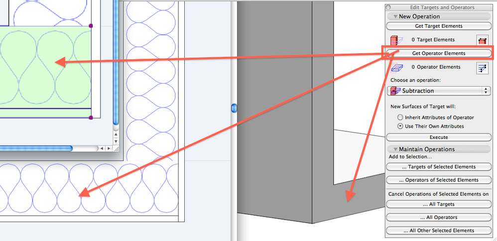

Rod Jurich
.................. well with SEO you almost get a perfect result.
Rod Jurich
AC4.55 - AC14 INT (4204) |  | OBJECTiVE |
Gerald Hoffman
Rod to me that is the perfect result as that is how the gypsum wallboard ( plasterboard ) would be applied.
