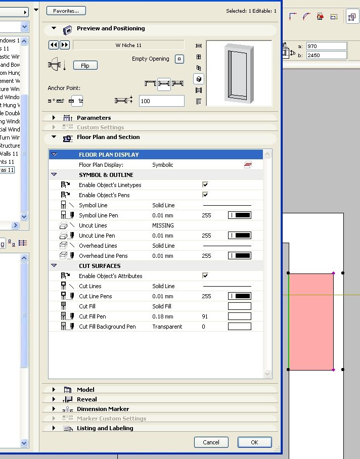

hi, in my project i have lot's of niche. problem is that in floor plan appears ugly pinky colour. i want get rid of it. tried everything. any advice?

You can find your object's pens in the Parameters tab, under 2D properties. (Hint - they are enabled in the tab you have open!) It's probably the background fill pen that's pink.
not exactly-there is no option.look

Ctrl-Shift-O when niche selected. Under parameters tab you see gs_fill_pen_2 (Niche Fill Pen in 2D) and remove the cross from the display column prior to gs_fill_pen_2. Now it is shown under parameters tab. Though you have to save edited niche as a new object and don't forget to change the niches to a new object you just saved.

thank you! great help!
