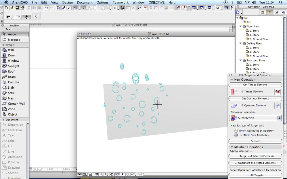

i'm using the student version on a mac and i still can do it,below is the best i can do.

Hey Alvin,
We will get there in the end!
In the SEO dialog box select the beam as the operator, select the wall as the target. Choose subtraction as the method, then press execute.
Don't delete the beam afterwards - leave it in position, but turn its layer off in the layer settings.
Hope that helps!
thanks you very much for putting up with me,i have now done it thanks for all the help guys

Do you really need SEO for this? I thought beams cut through walls by default? (unless you've changed their intersection priority)
i don't think i change anything to it.here is a pic anyway

I never rely on the natural hole-cutting ability of beams. I always change the layer intersection number of the SEO layer to a deliberately high number so I know any geometry on it will never accidently affect any other walls when turned off. Using SEO puts me in charge of what gets trimmed or subtracted!
