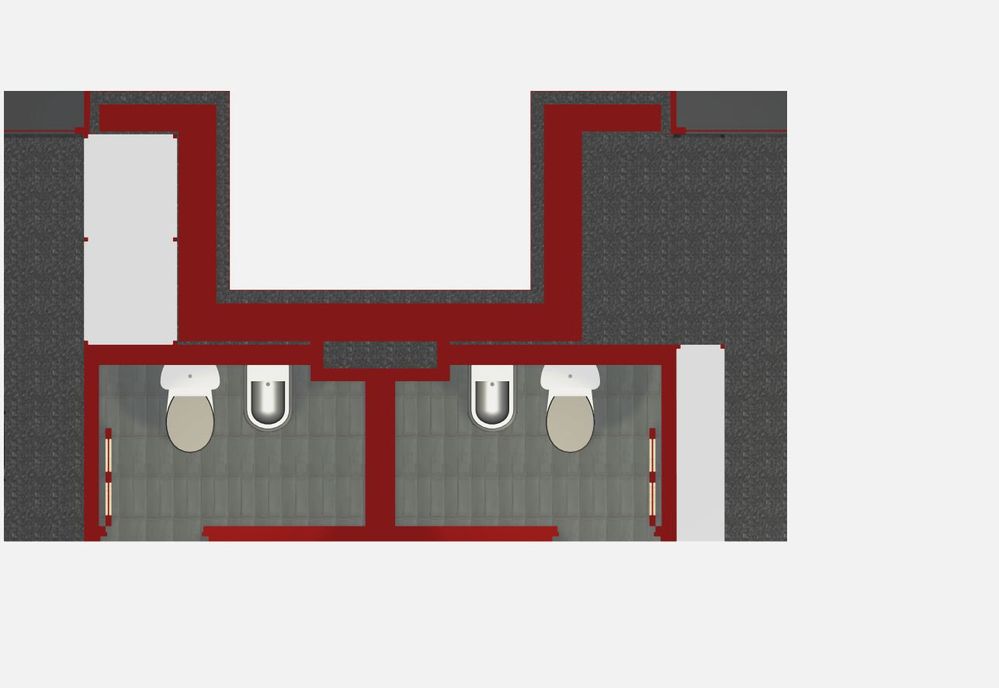

problem with cutted walls
i am working on a render of my floor plan and the walls that are cut by the plane are shown in red!
i would like them to show in black
can this be changed? where?
thanks
ps: i attach a picture showing the problem
2 REPLIES 2
Erich
This color is set in the 3D Cutting Plane dialogue box found under the view menu typically (unless you have customized it). It can be whatever you want.

thank you Erich.
immediately after i read your answer i remembered it was there.
