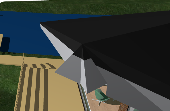

problem with intersecting roofs
how do i get rid of these pointy thingies? I tried SOE, but without succes.

Tim:
It looks like the edges of the Roofs' ridges are not vertical: try selecting the ridge, the Custom Edge Settings in the Pet Palette (top right) and setting the angle to Vertical.
