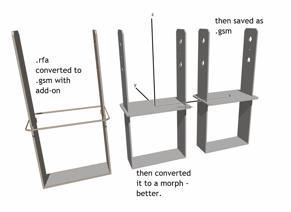

This is an example of how .rfa files don't always convert properly using the add-on.
1 Reply 1
Lee Hankins
I’ve had issues where the rfa object has multiple options within it and when converted it displays all options together as one with no way to control it.
