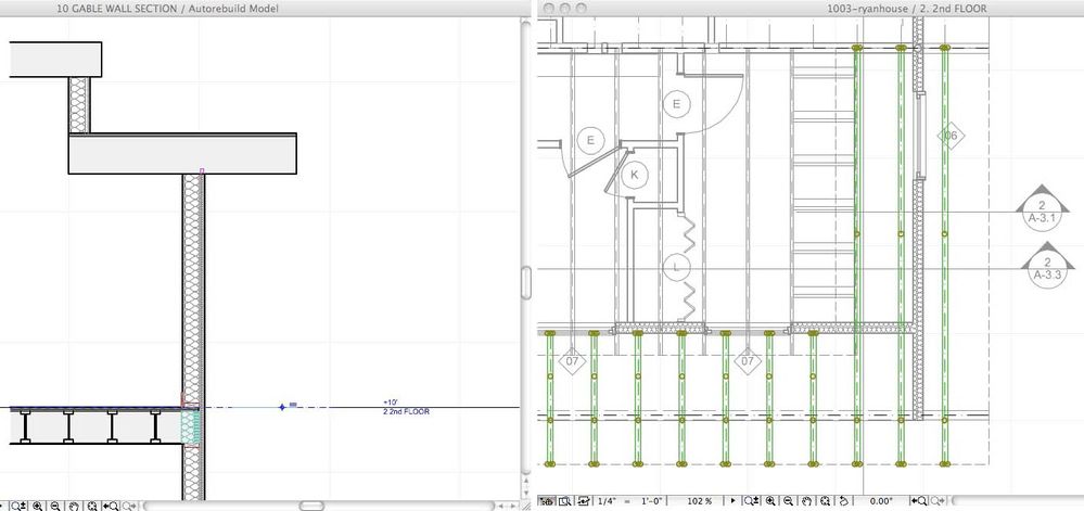

I'm a pretty new AC user, and I am working on a wall section of a 2-story building. I modeled the rafters with the rafter tool, and I modeled the second floor joists by making beams and dragging copies at 16" o.c. What I've discovered is that when I go to the section, the joists appear, but the rafters do not. Is there a setting that controls this? (see two attached images)

when you go to the 3D window do joists and rafters show?
Could the rafters be on a layer not set to show in the section?
Are the rafters not at the correct elevation?

AHA! that was it; it was a layer off. I am still not used to what layer settings stay with which type of view. Thanks a bunch! That fixed it.
