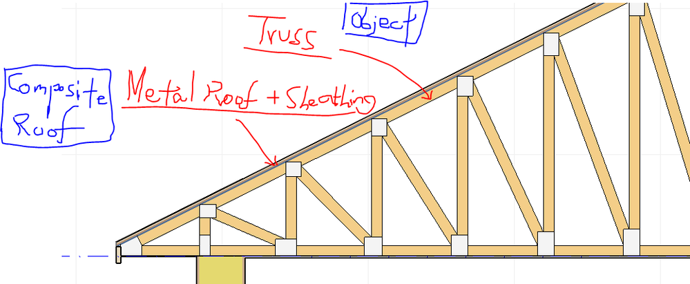

Rrrr Finally made the truss. trying to use a slab for plywood. It won't go to angle of the roof. Any suggestions?

Umm a slab can't be rotated: it's always "parallel" to the ground, or the horizontal plane.
I believe you're trying to model the roof sheathing? If that's so, you shouldn't use the slab tool, use the roof tool. You can define your own composite, i.e. 1/2" Shingles + 5/8" Plywood, and place it on top of the roof trusses. See this video on how to define a composite. http://www.youtube.com/watch?v=S6kuMxyr4DY
. Although it's for ArchiCAD 17, and you might be using earlier versions, it'll still work for you.
I suggest you use the section view or elevation, because it's easier to place the roof accurately. See attachment on how I did it. Good luck
Thank you, Of course it makes perfect sense now!
