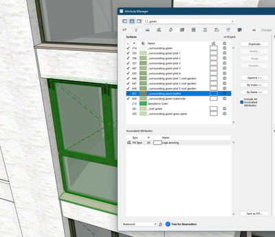

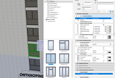

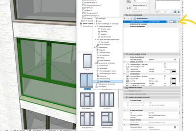

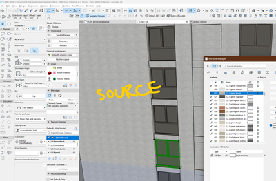

In our Source file the window uses a surface named _L2.1 gevel kozijn for all windows components: Frame, Turning part en Surface Sill
Screenshots Source model surfaces:

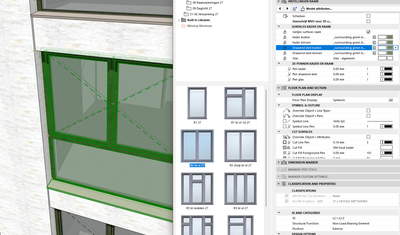

However in our Main Model the surface suddenly is switched to _Surrounding green buffer, but only the Frame and the rotating part . The Surface of the Sill has remained the same _L2.1 gevel kozijn
Screenshots Host model ( Main Model) surfaces :
You can see that the window has the grass surface^
The issue comes from the attribute indexes.
Index of the  _L2.1 gevel kozijn surface is 657 in the source:
In the target file _surrounding green buffer has the same index.
Obviously, In MainModel Archicad has started pulling the index of the Surface instead of the Name, but I do not think that is normal behavior.

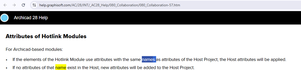

I believe what you are saying is not true,
Here's an excerpt from the Graphisoft Help Page: https://help.graphisoft.com/AC/28/INT/_AC28_Help/080_Collaboration/080_Collaboration-57.htm
We never had synced up Indexes, we were always relying on keeping the names the same.
I just checked the files we had in v27. The mismatch in the indexes is also observed there, but refreshing the modules never put the matching index Surface instead of the matching Name surface.
=> It is possible that there are mistakes in the library objects, but we do use the same libraries as in 27.
