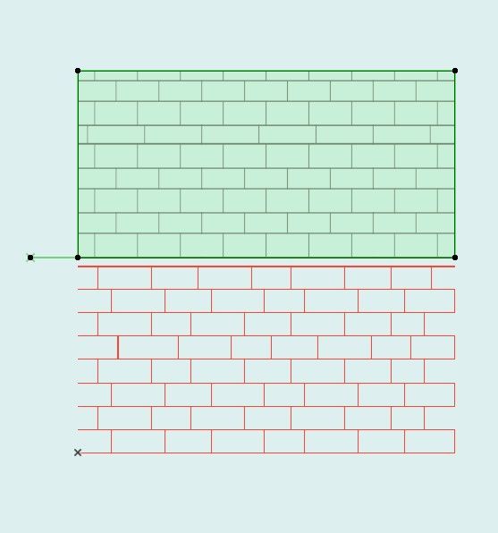

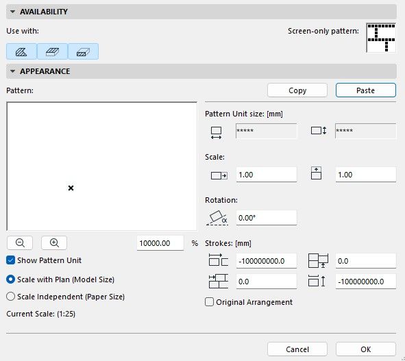

I am trying to make a Fill that shows the stone coursing for an ashlar wall.
When I copy and paste the 2d lines,  the fields for the overall dimensions display ***** not the dimensions.
Is it me or is it ArchiCAD 28 or is it because I'm on a PC not my beloved Mac?
See screenshots below.
AC versions 3.41 to 28.
Using AC28.3.2 (6200)  UKI FULL
Windows 11 Pro Intel(R) i7-10700K 48Gb RAM
ArchiCAD 3.4 - 28
Windows 11
Setup info provided by author
1 Solution
Graeme
I ran "linework consolidation comand" on them again and it worked! I had exploded the polylines and ran linework consolidation previously and when I did the zoom to selection nothing weird was happening but running "Linework Consolidation" fixed it this time.

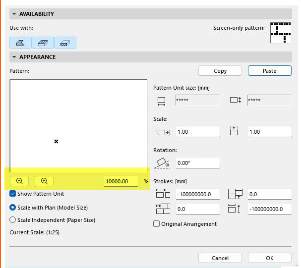

You are at 10000% zoom.
Try zooming out and see if that helps.
Patrick M
Ace
yeah, either zoomed out too far, or you selected elements that are farther from the group of copied elements than the fill can process. You have a stroke length of about 600 miles (100000000000.0mm). that makes me think maybe you copied a group of things, and part of the group is WAY off to the side.
Try suspending groups, re-select and copy the contents again

also, I dont think this is the issue, but make sure your fill primitives are limited to lines and fills... I know using polylines causes weird things, but not seen it do the **** thing
