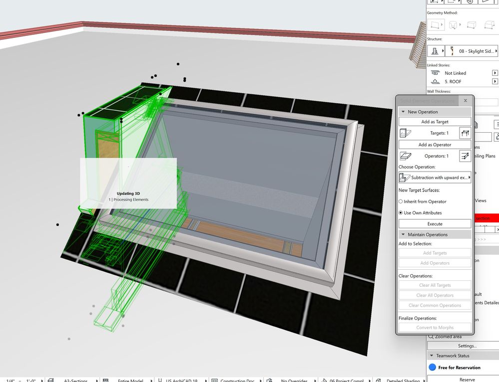

I am having trouble with complex operations too. The attached image is for a skylight (modeled as a complex profile wall), and the operator element is a morph (with waterproofing material set to the strongest priority). I keep doing this operation, but eventually it stops working and the wall comes back to its origen.

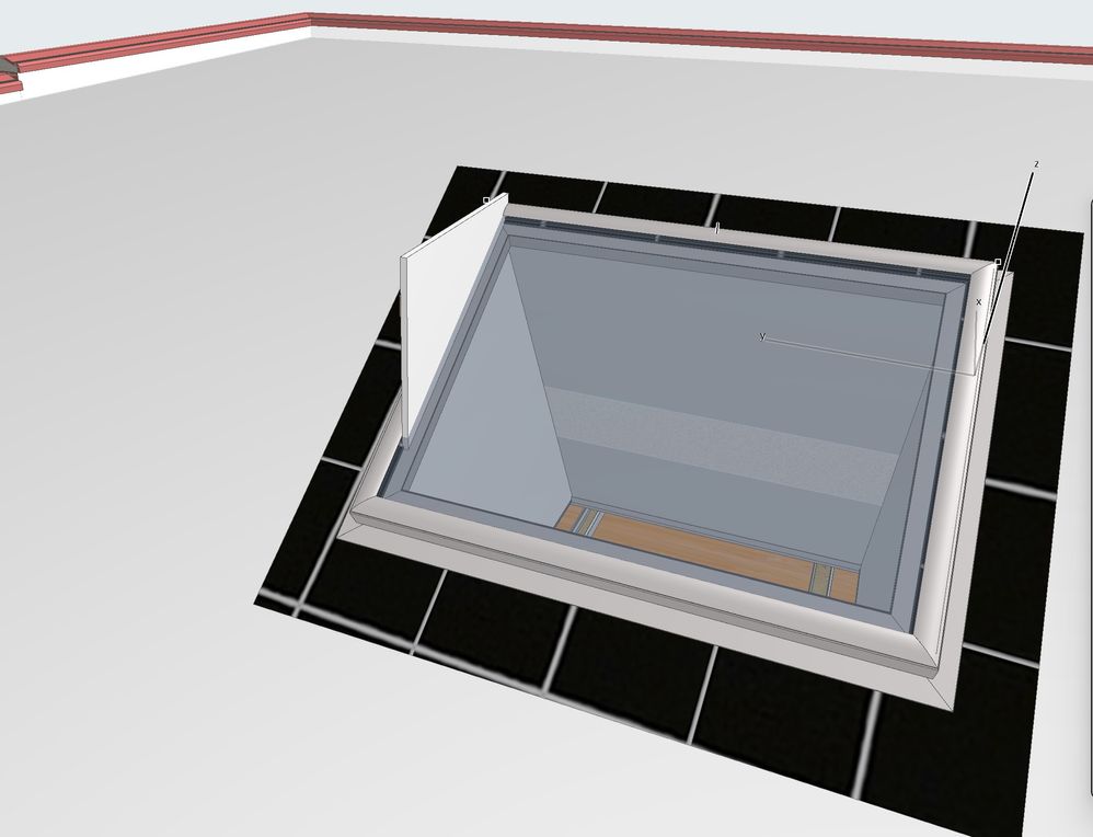

The solid operations worked, yet this is dangerous because I am not fully aware why it worked!
