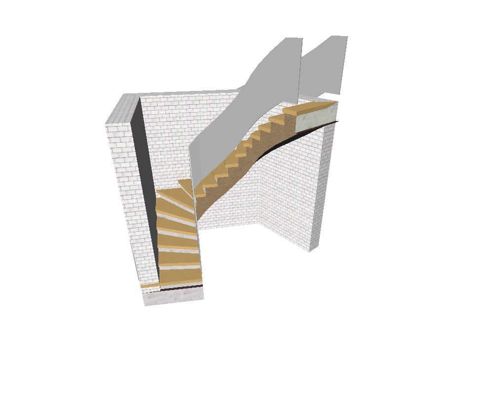

There is a big problem with Solid Element Operation related to stair and wall.
I want the wall under the stair to be cut by the stair.
if I use no rail to the stair the operation "extrude with upwards extrusion"
works ok but when I try to use any rail then the Solid operation is gone and the wall is back again to its original form.
I'm using AC11 International and Greek RC6 version with the latest update. the same problem appears to AC10

and tis is without rails

One work around would be to use the stair with no rail for the SEO, then put that stair on a layer that is hidden and has its own Layer Intersection Group number (so it does not interfere with other elements), then place the stair with rails on a visible layer for your project.
HTH
David
David Maudlin / Architect
www.davidmaudlin.com
Digital Architecture
You can also use the old school approach and place a roof element on a layer that you will turn off and use the roof as an "operator" to cut the walls with an "upwards extrusion". Turn off the "operator's" layer and the cut remains although the roof is gone. Your stair is a bit more complicated than a straight run, but you should be able to handle the "turn" in the stair by hiding several "operators" within the thickness of the stair. As long as the wall doesn't emerge past the top of the stair, then it should be good enough.
I know how I can trick this out but it is not a solution to the bug. what in case you have a lot of different stairs? u have to do the same thing again and again.
