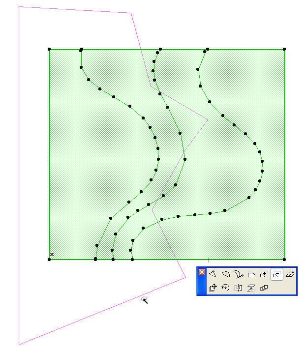

evivas wrote:There are 2 ways...
does anybody knows how can a mesh be splitted into different parts?
1. Use the split tool to create a cut line.
2. Move one of the boundary nodes to outside of the opposite boundary... Like splitting a blob...
Hope it helps...

using the split tool I can create a line. the problem is that I want to split the mesh using a polyline.
Can I use, in a way, the split tool by creating a polyline??
The second way does not keep the shape of cut mesh.

evivas wrote:No. Only straight cut lines are available.
But before you start making final cuts this way, you might explore the SEO options. You can easily make a polysegmented cut by using for example a hidden slab with a segmented face, or a segmented wall, as subtraction operator. And this operation can be reversed or changed at any time!

evivas wrote:You could try closing the polyline, then magic wanding a subtraction out of it. If you wanted to keep the separate parts, you'd have to copy the mesh first and repeat the process for each side.
Cheers,
