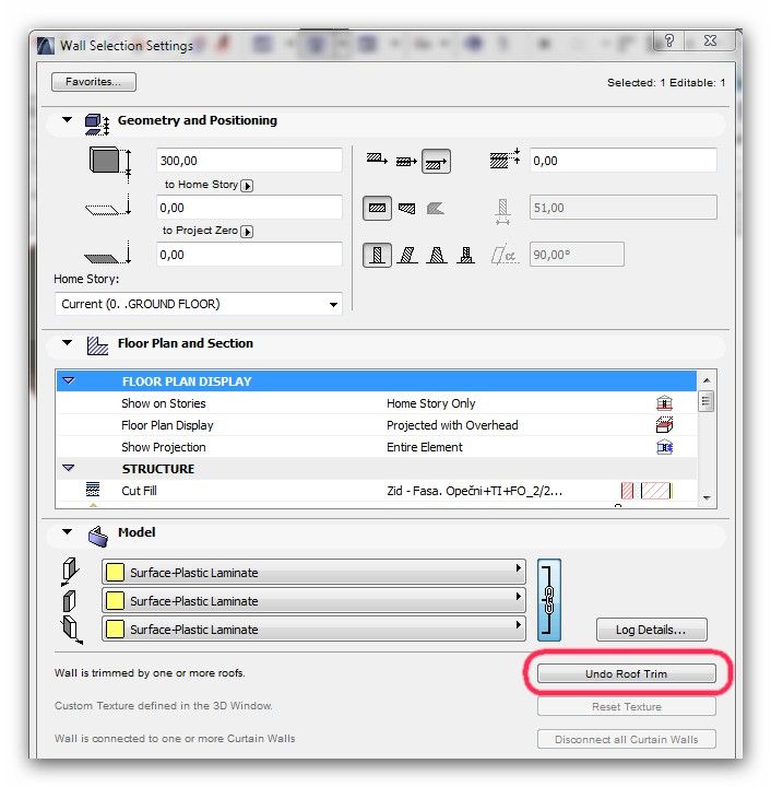

You have to Undo Roof Trim first, then repeat Trim to Roof operation.

Thhx Andro for the tip on the undo roof trim. I didn't know about that.

Thank you Andro, did not know that too! And was driving me crazy when I had to change something.

The original 'Trim to roof' - now called 'Crop to single plane roof' is a fixed trim/crop.
You can delete the roof and the wall will remain cropped - you have to 'Undo all crops' in the wall settings to remove it and then crop again if need be.
