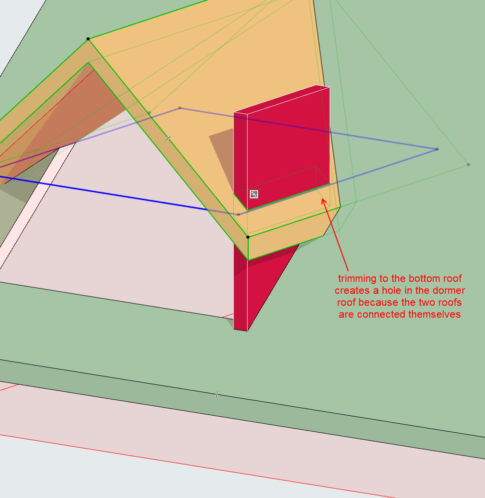

I wonder if anyone has come across something like this. I have two roofs that I trimmed to each other. Then I tried to trim the dormer walls to the two roofs and here is what stumbled upon. It could be that it has always worked this way, bc until now I only used SEO to trim my walls to roofs.
The dormer wall on the right, I had it trimmed at the bottom to the larger roof, which worked fine, but when I tried to trim the top to the dormer roof, nothing happens. Not only that, but when I tried to SEO to the dormer roof, still nothing.
The dormer wall on the left was SEO-ed to each roofs and it cleaned out nicely.

Question is, has this always been "working" like this or it is a bug? As I said, haven't used trim much before so I can't tell.

Yes, the wall in the background has been trimmed down by the larger roof bc I didn't want the dormer side wall to come down into the attic; it should stop at the roof (it asked the direction, as you said), but the issue is that it cannot be trimmed/SEO-ed up by the dormer roof, so that the upper part doesn't stick out. That's why I left it sticking out. Wall in the foreground has been SEO-ed up and down by both roofs.
Again, the issue is that you can only trim/SEO once, in one direction, even if you use different roofs. Bear in mind my two roofs have been trimmed to each other so that might have something to do with it.
So I want to know if this is how it works or it is a bug.

Your dormer roof may be set to pivot lines down and the wall may be outside of the pivot line, so it will not trim to that upper roof.

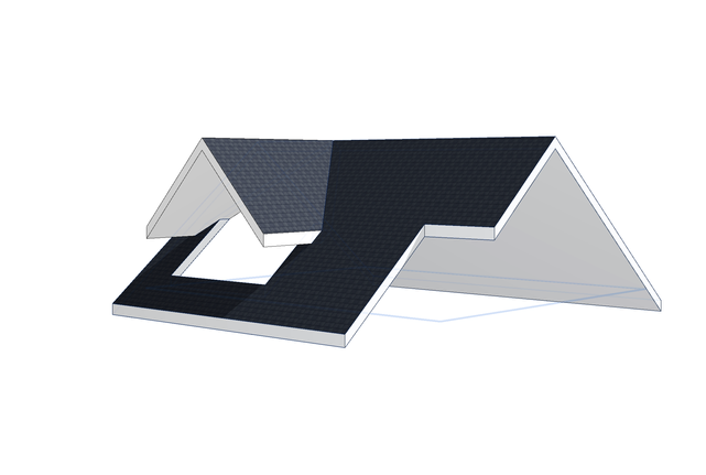

Because your main roof and the dormer roof are connected, when you trim the wall to the main roof, it creates a hole in the dormer roof as well.
Select the dormer roof and you will see the hole.
Because there is a hole in the roof the SEO will have no effect - there is no roof passing through the wall to trim to.
It seems that the connect > trim to roof does not work either as the roofs act as one when connected.
So, 2 solutions I can think of.
Only use SEO and subtract with downward extrusion to the lower roof and with upward extrusion to the dormer roof (the roofs can stay trimmed to each other).
Or don't connect the roofs, but you will have to manually cut a hole in the lower roof that is the shape of your dormer.
Now you can connect > trim to each roof.
