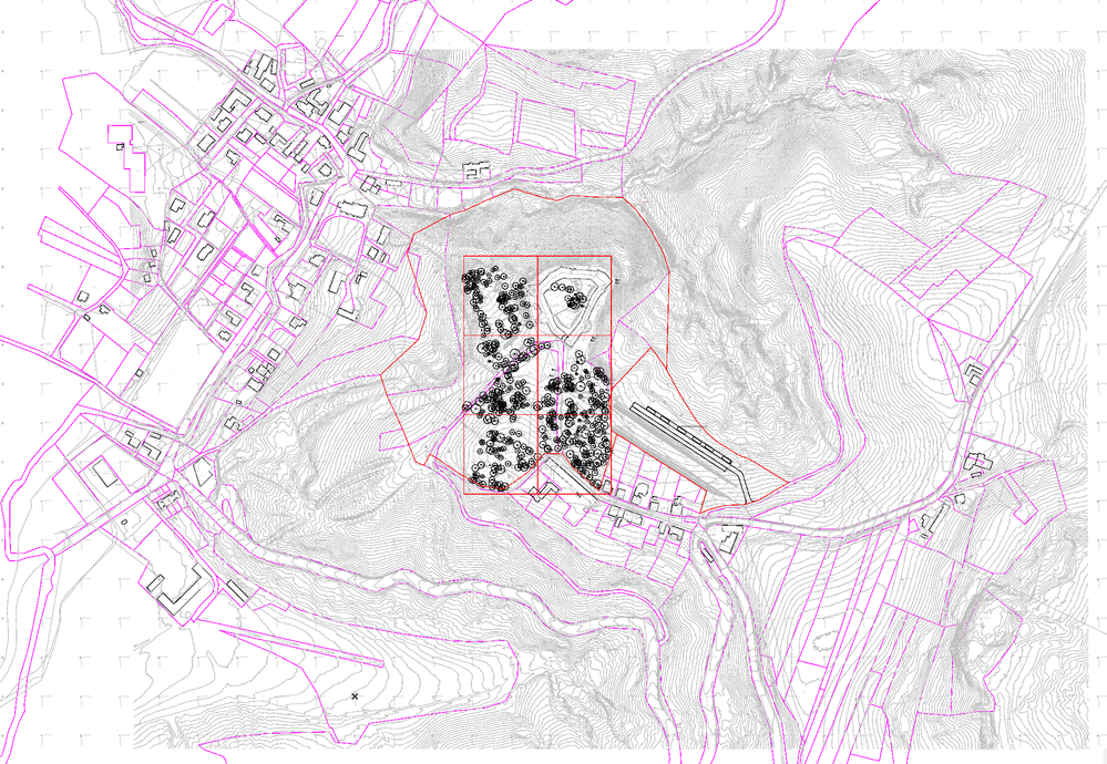

Hi everyone,
I’d like to hear some honest opinions from people who are using Archicad for landscape projects.
I’m currently working on a project that covers a fairly large area. I imported a geodetic survey plan with 1 m contour lines. It’s detailed, yes, but nothing unusual for landscape architecture. The problem is that the file becomes extremely laggy as soon as the contours are visible. Zooming and panning slow down a lot, and rebuilding views takes far longer than it should.
I’ve already adjusted my settings to favor performance as much as possible, and I’m running this on a very high-end machine (i9-14900K, RTX 4090, 128 GB RAM), so hardware really shouldn’t be the issue. I can make it somewhat manageable by constantly turning layers on and off and being very careful with what’s visible, but it’s still far from comfortable to work in.
What really makes me question things is that the exact same survey drawing runs perfectly smoothly in AutoCAD.
So now I’m wondering: is this just how Archicad handles complex 2D vector data? Is there a better workflow for dealing with detailed contour information? Or is Archicad simply not the best primary tool for larger-scale landscape projects?
I’d really appreciate hearing how others deal with this kind of situation.
Edit: As seen in task manager, the CPU usage doesnt go above 10 %, and cpu usage doesnt go above 20, when panning and zooming around (when everything is very very laggy).

I dont! These are 2D polylines. Sorry, forgot to mention that i am not 3D modelling anything (yet), this is just a 2D geodesic survey drawing in archicad.
Here is a screenshot for additional context:

This is different then.
A complex 2d in Archicad imported from Autocad will probably cause lagging. The 2d engine of Archicad is different than Autocad.
So you have to optimize the DWG.
I would turned off the ISO lines or deleted them prior importing and create new ones via the object I sent you...
I don't know if purge or kill commands in Autocad will make any difference. Each case is different.
