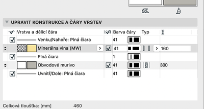

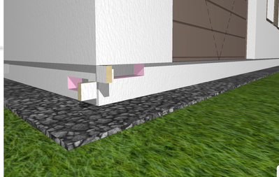

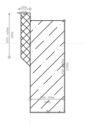

Hi, im trying to make a fasade that consists of 2 izolation materials that are different in thickness, the wall on top is just a composite wall made from brick and isolation, the lower one is a "profile". The profile wall is causing composite wall to extend or make holes. Thanks for any help

Change the Reference Line position of one of your walls. This generally occurs when multiple walls have their Reference Lines overlap. Alternatively, you could do your footing as a beam.
Ling.
ps. If the walls overlap vertically, even between storeys, avoid having their Reference Lines overlap in plan.
