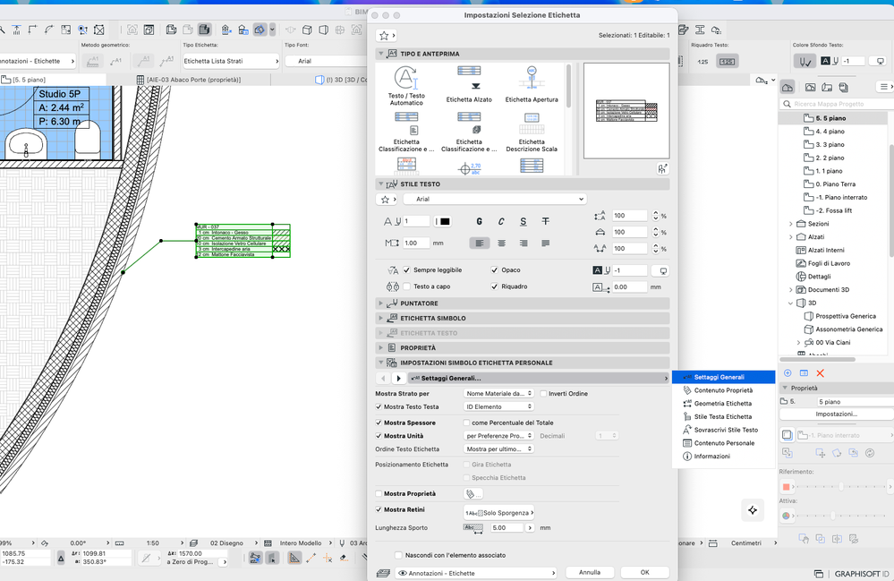

Can someone help me understand why the fill patterns in the layer list do not match those of the composite wall?

Do you have an active graphic override on your fill types? If so, they won't be picked up by the Skin Label object with the override, just the basic building material "default" fill.
