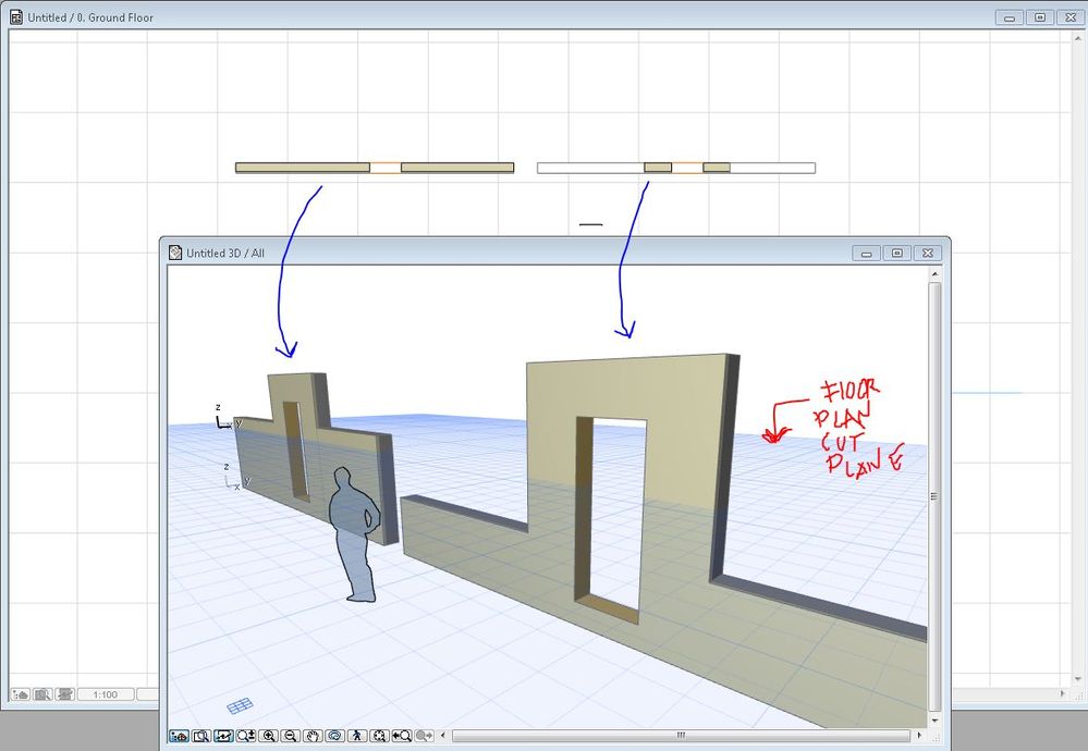

I really don't understand the opening portion of the problem... for the walls in different heights, it depends on the Floor Plan Cut Plane level ( see Pic):
If you're cutting above it will show the wall end lines, if cutting the walls, no wall end lines will be shown.

my cutting plane is set to 4' in this example one wall is cut and the other two are not, but i still don't see a wall end. maybe i'm misguided here, but in the olden days if i wanted to indicate a pony wall in plan, i would draw a line where the wall heights changed, i thought this was standard, but i'm self taught so i don't really know. but at the same time, if i flip a segment of wall so that the outside is the opposite to the adjacent wall segment, then a line shows. in this case it doesn't matter, but when i want to show the openings in a foundation wall for doors it is necessary. i just had an epiphany, i should use empty openings for that. but still, if i want to indicate differing wall heights i thought this is the way, unless someone can enlighten me.

As you have discovered if the reference lines are in line then the walls join with no end lines regardless of their heights.
Even if the walls have different composites (fills) there is no end line which in my opinion is a bug.
There is a setting that allows you to turn the end lines on or off but it makes no difference when the reference lines are in line.
Erich
If the middle wall is on a layer with a different layer priority the wall ends will show. Sometimes this is a useful trick, other times not so much.

Just make it so the reference lines do not line up (put the middle wall on the opposite side or a little bit inside the wall).

I have a separate layer for walls that are not full height as i do not want them showing on my reflected ceiling plans, this layer has different priority so I get wall end lines.
If I have a step in low walls I change side of insertion line so they don't join
