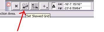

Note that if the Slab is not Orthogonal with the current "x" , "y" Axis you must re-align your Axis with the Set Skewed Grid Button. Just Click on the button then select the edge of the Slab.
