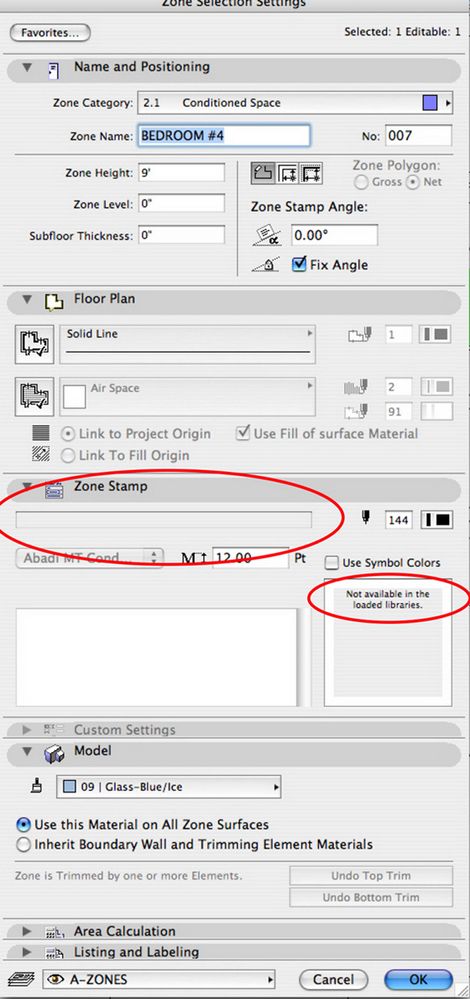

While upgrading an ArchiCAD 11 project to 12, I can't seem to get my zone stamps to upgrade also. They continue to use the version 11 stamp, and if I try create a new stamp (even in a new file) and copy it into my file, everything always reverts back to the 11 stamp. This also holds true if I remove the 11 migration folder, only then the stamp just can't exist.
Any thoughts?

Zone stamps are associated with Zone Categories, which in turn are attributes that are embedded inside a project. Simply loading a project in a newer version, and even loading a newer library, will not change these.
If you want the old zone stamps, you'll have to load them. If you want to use the new stamps, you'll have to change your zone categories to specify them.

thanks Karl! I found that in options. work perfectly!
